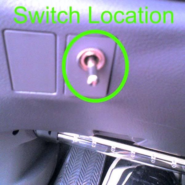

measure a piece of wire from the ac vent to where you want to put your switch (i put mine on the lower left of the steering wheel)
switch

if your switch is going in under you steering wheel you should have 4 wire there,
for me 4 wires would not all fit around my switch terminal so i used one 3 inch piece of wire and attached it to the switch terminal, i then used the twist wire connector and twisted all 5 wires together (the 3inch piece, and the 4 lights)
to get power for the lights i attached a wire to the power terminal on the switch and fed the wire through the center to the cigarette lighter, i unscrewed the small bolt on the back and clamped it down on the wire and then tightened it
